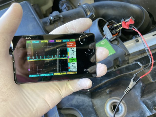

I have INPA on a laptop (that laptop has just failed, so will need to replace). I have good mechanical skills and have sound diagnostic skills. Attached is a photo of a palm-sized digital oscilloscope I use to diagnose a faulty aircon condenser electric fan that would not work. A test lamp confirmed power supply in the connector and the scope confirmed that the car's DME was sending a signal to the fan to get it to operate. The next step: spend $600 to buy a replacement fan assembly.
